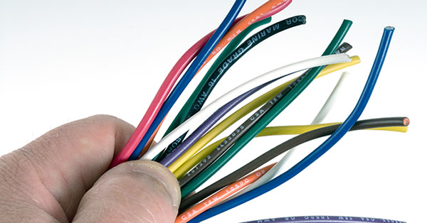

When I rewired my boat I found that all the original non-tinned copper wires were dark and slightly corroded even in the middle of a long run. I never found any “fresh” copper while cutting it all out. I bet that aging adds a lot of cumulative voltage drop and resistance to the system.
Phr3d
"dark and slightly corroded"
