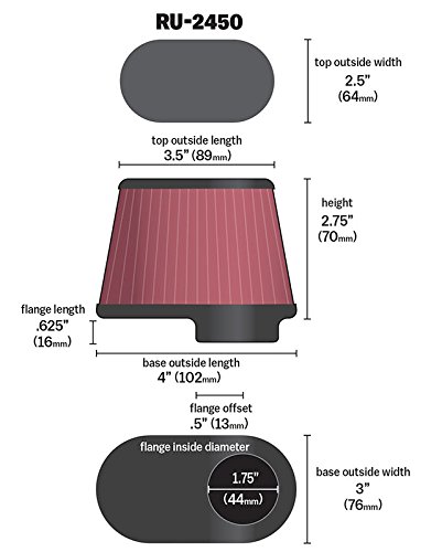

K&N RU-2450 Universal Clamp-On Air Filter: Oval Straight $39.99
https://www.amazon.com/gp/product/B00062YQRA/ref=ppx_yo_dt_b_asin_title_o02_s00?ie=UTF8&psc=1
That's about $12 more than the first one I bought a few years ago. Buy the K&N filter cleaner and you can clean and re-use.
Like Bigd14 said, you can drill and screw a hose barb into the flat underside and connect the breather tube directly to the filter.

Its a slip-on fit for an M25 in an E32-3.
Yes. Don't know about the M25XP, but the intake on my M25 is 1-3/4" in diameter, so any slip-on with a 1-3/4" ID flange will work.
