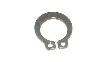

On a somewhat related note, the retraining clips that hold the sheave axel can be difficult to find. All the clips available at my local stores were either too thin or not made out of stainless. I kind of got lucky and found a good replacement here:
I just finished the rerig so they haven't been on the boat too long. Hopefully they're actually stainless and will hold up just as well as the original ones that I bent while taking everything apart.
