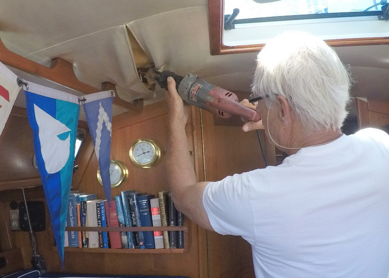

Strictly FWIW, when I replaced the old pair of factory Lewmar 4-sheave organizers on our housetop, the new Harken organizers did fit the same holes. I was able to over drill/epoxy fill/redrill with no problems. This also enabled an upgrade to ball bearing sheaves.
(Even if the holes did not quite match, I could have epoxied in the old ones and drilled new ones beside them. The base of the new organizer fitting would very likely cover the old fastener holes. Perhaps?)

Strictly FWIW, when I replaced the 2 factory Lewmar organizers on our housetop, the new Harken organizers did fit the same holes. I was able to over drill/epoxy fill/redrill with no problems. This also enabled an upgrade to ball bearing sheaves.
Lucky man. I tried a new Garhauer, and then a Schaefer, organizer, neither of which lined up properly. The Schaefer failure was particularly galling, as I purchased them on sale from WM for $46 each - down from their usual $189. I'm just going to replace the sheaves and see what's what. The Schaefers will remain mothballed for potential future use.
