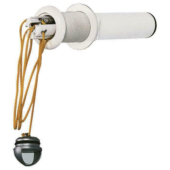

@Kenneth K - Just for reference, there is also this link to purchase the tube ladder from the UK. ~ $US 66. + shipping and tariffs(?)
