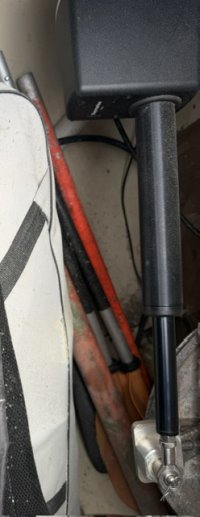

Do you have a photo of your damaged quadrant?

To this point, can you provide some pix of the quadrant? Maybe reach in with your digi-camera (iPhone?) and take some px? I recall that these castings can show an uneven surface from the casting process, and have odd lines on the surface that may look like cracks, but actually are not.
Edit: a picture or two (older, but still the same) in this thread: https://ericsonyachts.org/ie/threads/quadrant-stop-on-yacht-specialties-pedestal.3473/#post-19357
Does your quadrant look like this? I know that the stops are likely different on your model.

I will try to get some pics next time I am there. The crack is coming from the twist induced from the steering quadrant stop pin hitting the stop block.
The quadrant is edson, its identical to this one Also the quadrant is Edson, its identical to this one: https://sailboatrefit.com/quadrant-removal-and-rehab/
Edson can probably sell you a new one, not the case with defunct YS/merriman.
The quadrant/radial rarely hits the blocks when sailing. Usually damage occurs when somebody backs up fast and looses control of the wheel, allowing it to slam over. Doubt that would happen again.
