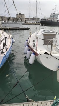

Me and some friends are currently working on refitting an old Ericson sailboat, but we've hit many problems and would really appreciate some help and advice from the community.
1. We can’t identify the exact boat model and year
Unfortunately, there’s no plate or serial number visible anywhere on the hull or cockpit. We don’t know the exact model or year of the boat, though we suspect it's from the 1970s. We are looking for particular details in order to be able to trace the exact model, so if anyone can give us a hint as to where and what to look for, we would greatly appreciate it.
2. Structural issue under the mast
We’re dealing with what seems to be a fairly common issue on older boats:
There’s a visible crack on the cabin top where the mast base sits.
The bulkheads that anchor the shrouds also look quite old and may need replacement.
The area under the mast is hollow — there’s a gap between the cabin sole and the actual hull, with no structural support between.
We're considering reinforcing the whole area by:
-Repairing the cracked deck
-Possibly replacing the bulkheads
-Adding a compression post under the mast
-Building a solid mast step below the cabin sole, to transfer the mast load directly to the keel or hull
We’d love to hear from anyone who has tackled a similar issue:
What’s the best way to structurally reinforce this kind of setup? Do we really need to work on each of these aspects?
Tips on compression post placement and step construction?
Materials and methods that worked well (or didn't)?
We shared some photos, if you need more images or close-ups, just let us know — we’ll be happy to share them.
Thanks in advance for your help!
