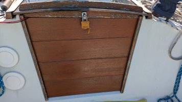

Worked on the nav station a bit after removing the winter cover today
JP in Sandusky
E38 on Lake Erie
Nice. I'll be curious to hear your thoughts on openCPN after some use. Every photo of these nav stations I see still has the corded desklight/flashlight. (mine also) Do you use that?

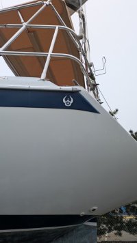

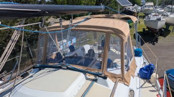

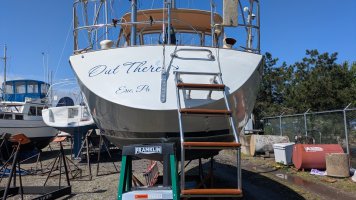

Todays progress...
  1. Got the name on and replaced the logos on the back of the cove stripe
  2. Reinstalled swim ladder steps after refinishing
  3. Canvas guy is almost done, just waiting for the connector
Todays progress...

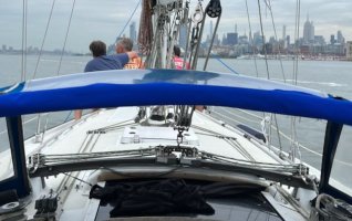

Quick question for you - how smoothly does the main sheet work with what appears to be a single block in your second picture? For comparison's sake, here's what it looks like on my 35-3. I've thought about changing it because my main is not always easy to ease, especially in lighter winds. (This photo is several years old. Every line here has since been replaced.)
Out There
1988 E35-3 on Lake Erie
From memory and the picture it is a fiddle block so it does get a double purchase but to your question I do not have any trouble easing the main that I have noticed. I will take a closer look this Friday when we drop her in the lake. :D
Will be interested in your findings. I'd read, or been told, that with mid-boom sheeting on a boat like ours a 6:1 purchase would be necessary. But since mine - which came this way - worked, aside from not easing great in light winds, I never changed it. Yours would indicate it works with even less than 6:1, if I'm viewing the photo properly anyway.
It's a good question. Generally I have found that less is more regarding mainsheet purchase.
For one thing, there's a winch, if a hard set is required. And in light air, the less friction the better.
When the wind comes up, we reef, and with a reef in, purchase necessity is reduced. With two reefs in I can trim hand over hand even in high winds.
A mainsheet clutch comes in handy when reefing, if the mainsheet winch does reefing duty. But that's the only time it does. So I'm against them. I use a cheap clam cleat when the mainsheet is free during reefing, if that. Usually i just let the mainsheet lie there, since the sail is luffing anyhow.
But to each his own, of course. Cruising gear should be simple, I think. We are not racing in a gale.
