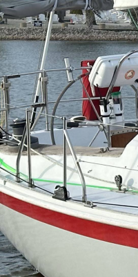

Taking the tackline to a cleat works but limits control of the kite. It will also put you in a bind if the wind pipes up. Attached photos of the tack ring on the anchor roller bail(1st picture), the tackline runs back to a clutch on the starboard outboard track(2nd picture). Having the tack out in front of the forestay helps with projection and reduces chafe. Also here is tutorial on a letterbox douse.
