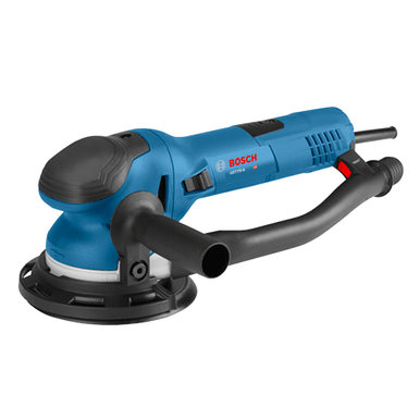

I typically never run a sander without a vacuum attached. I consider the dust catchers that come with the unit to be whimsical at best. There are multiple adapters available for different hose sizes, but if I find myself without, i just use tape...sort of an unseemly arrangement but it does work. When I did the bottom on Emgee this past spring I started with 80 grit paper then quickly changed to 40 grit, then back to 80, then fairing work then last pass with 100 grit. 9 layers of paint to remove and shop vac collected over 30 lbs of "dust". Use moderate pressure and let the sander/disc do the work.

I struggled way too long with the stock hose on my shop vac. It seemed to never fit the tool and wasn't very flexible. I finally ordered this set up a few years ago. the quick connect fittings and flexible hose make it really easy to use. With the mesh sanding pads and a vacuum on the Bosch, there's very little dust.

If you do not need dust collection look into the Porter Cable 7345 Sander and Mirka Coarse Cut or Gold sanding disks. These are adhesive disks but they do last really well. The tool is relatively inexpensive and bulletproof. I spent hundreds of hours behind this sander on my E27 project sanding everything from newly laid up rough fiberglass with 40 grit to primer with 220 grit. Great tool and great sanding disks. The pad on the sander will eventually get dust in it and shoot sanding discs across the boatyard (wear your safety glasses!), but you just clean it off with acetone and its ready for the next disk.
I have also used my DIY yards Bosch 6 inch ROS for bottom paint with dust collection and the hook and loop system seemed very robust.
