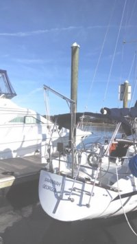

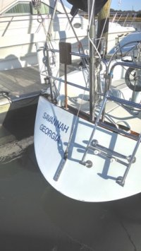

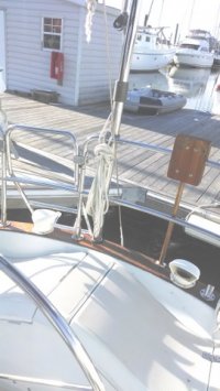

Pictures of Outboard Davit
Steve and others,
Well I guess I figured it out. Here are the pics Rick alluded to. You might want to enlarge them a bit. A docking poll makes it hard to see the middle shot of the davit but you get the idea. The outboard (4hp Merc.) sits on the wooden seat which is supported by a broom handle (no need to tell the admiral where it came from. I advised her it was exotic teak) stained to match teak trim and cut to fit tightly so there is no deflection. The handle sits in a small piece of Starbroard with a hole drilled in it to keep the poll from wandering.
The davit arm comes in two sizes. 24 inch and 34 inch. The 32-200 needs the 34 because the transom sticks out as it approaches the water. I love this davit, It makes moving the motor almost easy.
Rick asked me to post some pix of our main doors but I will use a later post.
