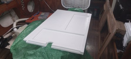

Made the board to sit and secure the battery bank out of 3/4 ply 20240731_160012.jpg20240731_173448.jpg

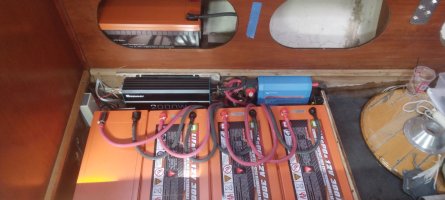

Few months later, ended up taking off the electric head and switched to a manual to make space for a different battery array. Four batteries instead of two.
Three solar chargers, one for port , starboard and deck panels individually. All with independent switch breakers for input and output.
It all sit snug here , but this changed a little when I upgraded the bank. Most of the wire remains the same. Now I have here another battery where the inverter and shore charger used to be.
Total of five batteries all with fuses independent at the buss bar and kill switch.

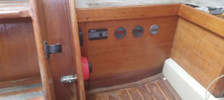

On the A/C panel installed a voltage/amperage/consumption meter as well as a switch to choose power source ( shore / solar / off )
And the D/C banks are isolated. Have three banks .
Here we see the inverter switch and the battery banks meters. Have an Engine battery , house battery 1 and house battery 2 .
Also the solar array is divided. Solar on Bimini charges the house 2 and the solar on deck charges the house 1 and engine.

Made the board to sit and secure the battery bank out of 3/4 ply View attachment 54930View attachment 54931

That's a nice installation!
This has a lot of heat-generating components in a small space. Plus, the inner wall of the hull can get pretty warm when the outside is exposed to sun for long periods. Any thought to drilling ventilation holes in the top/bottom/sides of the compartment? A 12VDC fan might be even better. A fan that fit the curvature of the cabinet, plus a black mesh or grate to cover the rest of the opening might even create a sleek appearance.

That's a lovely set up Ky-Ed ...
I had to use a DCtoDC charger in order to take advantage of my alternator. Because of the difference in battery chemistry.
Alternator is using a beefy 1/0 cable upgrade on both ground and positive. I realized this 14 Gauge cable dilema about 700nm offshore . And that's when the upgrade was made.
