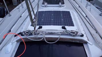

I’m using a ScanStrut DS-Multi cable seal for a flexible panel on top of the dodger. I remove the panel in winter even though the dodger is under a full one piece cover during winter. Strong winds almost ripped both the panel and the cover off the dodger.
I have a flexible panel on my dodger and I used this cable gland (without the fancy metal cap) on the outboard side of my coaming. It's very low profile: low enough that it is hidden by part of the dodger.
