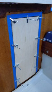

I'm currently remodeling the head on our E27, bulkheads have lots of holes to patch and need to be covered. There's plenty of nice wood elsewhere in the cabin, so thinking of covering them with a neutral or beige marine vinyl to balance things out and make the head feel a little more spacious. Seems like it would be easy to clean, is UV resistant, and will hide surface imperfections well.
Has anyone else done this and have photos (or insights) to share?

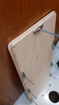

And sharing how I patched a large hole where a solid fuel heater once was. I used a router to cut a rabbet in both the bulkhead and the patch, which makes for a more solid and precise repair when epoxied in place. I used a bunch of toggle bolts to temporarily clamp the plug in position and align the surfaces (bolt holes will be filled afterwards).
