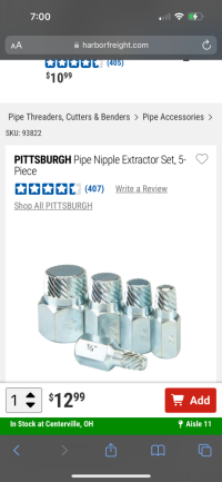

As for getting out that fitting… hmmm… backing it out looks pretty doable. Buy a set of “Easy out pipe nipple extractors” and screw it in, the threads are reversed so after it bites the fitting should just back right out.
