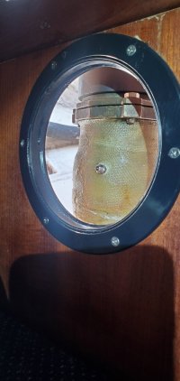

After a few years of a mysterious on again off again rudder clunk I dropped the rudder and found that the lower bronze bearing was worn on the starboard bottom and port top sides.
I read everything I could find on the subject and decided to go with the method described in the West System Fiberglass Repair Manual.
After lowering the rudder I lightly sanded and cleaned the bearing, coated the rudder shaft with paste wax and drilled a 3/16" hole thru both sides of the bearing from the outside of the boat. The rudder was then put back in place and I injected 1/2 of a West System syringe of the epoxy/graphite/406 mixture into each hole.
Returned to the yard this afternoon to discover that the rudder moved freely ( yeah.. I heard about that guy ) and the side to side slop was gone.
Managed to get the job done by myself in a day using wood blocks , the jack from my truck and way too many trips up and down the ladder to lower and then raise the rudder. Having a helper to align the spacer and quadrant as the rudder was reinstalled would have made this a fairly straight forward job.
As a side note over the years I have attempted to pump grease into the rudder tube via the factory installed zirk with no luck and discovered after pulling the rudder that there was never any grease in the tube from day one.
The zirk at the top bearing makes sense as the grease goes directly into the bearing.
Injecting grease into the void between the packing box and the lower bearing just doesn't seem to make any sense.
I'm tempted to install a zirk in the lower bearing but will leave well enough alone.
