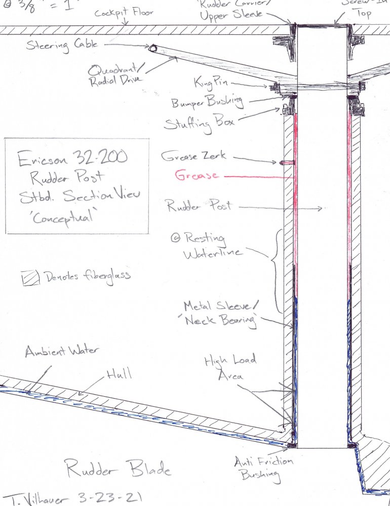

Here is my recent analysis of the same issue, complete with homemade drawing and factory diagram
Your boat is older so may be different. If you have an existing zerk, I would try to match the height. Otherwise I would try to go 6-8" below the top of your rudder stuffing box.
When you drill into the rudder log, probe gently as you push the bit in. You don't want to mar the rudder post and if the pressure splatters fiberglass thread shards into the center of the log, they may interfere with grease distribution and or create an annoying chafe for the rudder.
I also recommend you buy your zerk fitting first so that you can drill an appropriate hole that will sort-of create a tighten-able hole into which you can screw the zerk. I used some JB weld to help glue in the threaded zerk. I got these stainless ones on Amazon.
I have yet do do a full write-up or testing of my install, but there you go.

Thanks! Does anyone know how the dimensions might differ between the 32 and 35? For one, the rudder post on my 35-2 is angled--auxilary/emergency head is forward of the pedestal and takes a full size tiller rather than coming straight up like the 32. That shouldn't make a difference in the conceptual design, but I believe it makes the rudder post longer, and thus the bushings in the log might be positioned differently? I really have no idea what I'm talking about;) I just don't want to haul out to do what should otherwise be pretty simple.
Seems to me that the bushings are at the ends, so anywhere in the middle would make sense.
The idea is to drill through the tube until you hit the rudder post, so the Zerk will admit grease into the tube.
If for some reason you're not happy with the position of the Zerk install, you can always just leave it there and drill for another one.
It would be good to hear from somebody who has put a Zerk into a 32-2 rudder tube. Most reports here are about the -3 models, which have vertical tubes. But the concept ought to be the same.

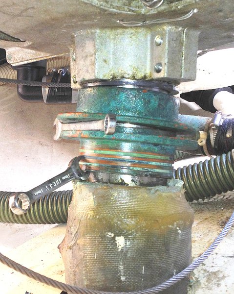

Update: installed packing and zerk fitting as follows:
packing: 5/16” fit perfectly
zerk: installed toward the top so I didn’t have to worry about water ingress. First, I drilled about 3/8” with 25/64 bit and then went all the way through with 1/8 bit, seeing as that’s all that’s necessary for the grease passage, and if anything ever came lose, it wouldn’t be much of a leak... the big inset was the perfect diemter to be able to screw in a 1/8 in MIP brass fitting, which fit really secure and didn’t bulge the fiberglass, but I still used thickened epoxy to encase it. I used a 90 deg elbow so the zerk would be angled toward my access point. I’m using a 1/8 MIP zerk fitting for now, but if I decide to extend the access point, it will be easy to do... Filled it up with a full cartridge of Green Grease.

For anyone following, I’m happy to report that it worked! Prior to the fix, my bilge pump was cycling 30-40 times/hour while under sail or motor (yes, I have a counter on it). This weekend, after 6 hours underway, cycles = 0!!! I’ll never know if the stuffing alone would have done the job? But my guess is that the grease will make it last longer if nothing else... Very satisfied.
