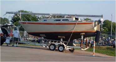

Welcome to the forum. As you probably know, most of the E25 sailboats were constructed not with the extended keel, but with the ballasted hull and centerboard. It seems that the market demanded the centerboard version since that was type friendly for trailering. This does not mean, though, that an extended keel E25 cannot be trailered and trailer launched. I cite as evidence for this the attached picture from the Ericson Forum from 2008. I can't remember what thread it appeared on, but I copied it and labeled it sometime this past summer when I was researching something on the E25.

picture of E25 extended keel being trailer-launched
Here's the picture that I neglected to attach to the last posting.

Thanks for the welcome, information and picture. I read in the owners manual that the keel version wasn't really designed for trailering and I was afraid I would have to let a very nice boat slid away. I was beginning to despair. Now all I have to do is modify a trailer to fit the keel. The picture you included should help quite a bit with that.

Glad to help. I'd try to send Randy Rutledge at personal message in order to get a few more specifics. For example, he told me that a tongue extension is a must. He also described to me less obvious techniques, for example moving or removing the aft most screw pads just before launching and retrieving.
