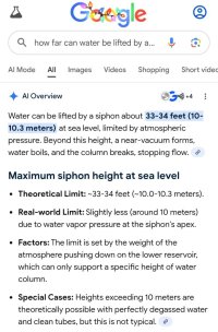

Kenneth here is the kicker about the 33 'imit. Look out your window and you will see plenty of trees that are well over 10 meters. I got cottonwoods nearby that are are about 55 foot tall. Explain that to me. I sit here in total awe about giant sequoia out west at like 300 feet or some thing like that!
Hmmm. Yeah, maybe because in trees the water is travelling through cells/membranes vs "tubes??" I mean, when you cut down a branch or a tree trunk, water stays trapped in the wood, versus flowing freely out of it. Still, an interesting thought....
And, in Denver, at 80% of sea level pressure, a siphon should only be possible to about 27 ft.
