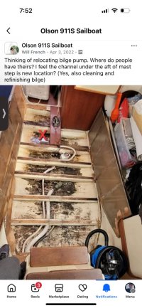

Ali, I also responded in the facebook group, but what the Olson 911 (and O34) have for structure doesn't match pictures that I've seen of the TAFG in the Ericson built boats. From what I've read, Ericson re-engineered the structure in the Olson 911 (and again assume the O34) to convert the boat from cored hull to solid glass. There are quite a few athwartship ribs that are glassed to the hull that are in turn bonded to the liner just like the pictures that Loren posted. I wouldn't quite call it a grid, but it looks robust. The Olson boats have very shallow bilges which does limit how much they can do while maintaining the headroom.

Thank you! I saw this post in the fb group that shows the hull of the Olson 911 - it doesn't match what I've seen of the TAFG, either. I'm seeing the boat in person this weekend, I hope it looks as nice as the pictures.
