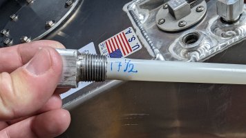

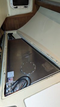

- Vanilladuck: Did Coastline put in the brass fittings and label everything (in your image above), or did they provide the tank and you had to get all the fittings? Trying to figure out if this will be plug-and-play.
- Prairie Schooner: what diameter are your inspection ports? Want to size up based on your comment. I see VanillaDuck has 8 or 10" ones.

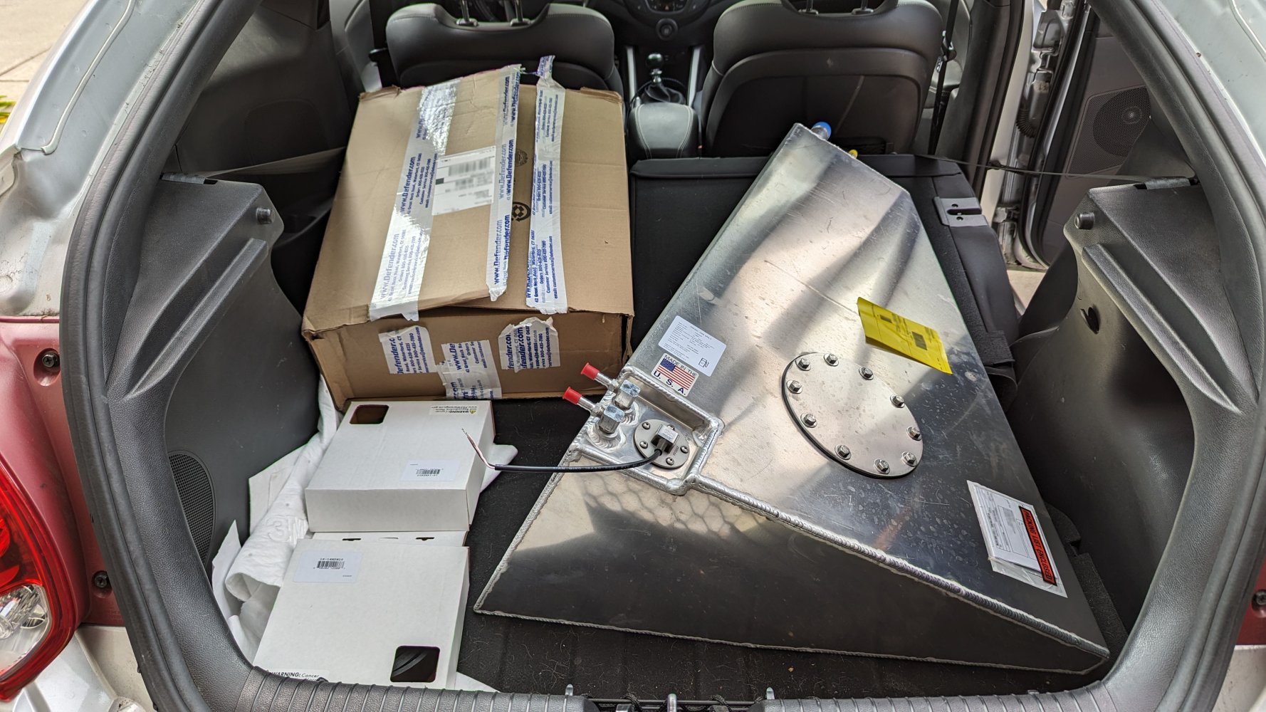

The fabricator installed prefab inspection ports in our tank. I'd have to be at the boat to measure, but going from my hand, I'd say no bigger than 5"- 6". There's not room to get an arm in and see what I'm groping for. Pic of our completed new tank before installation.
