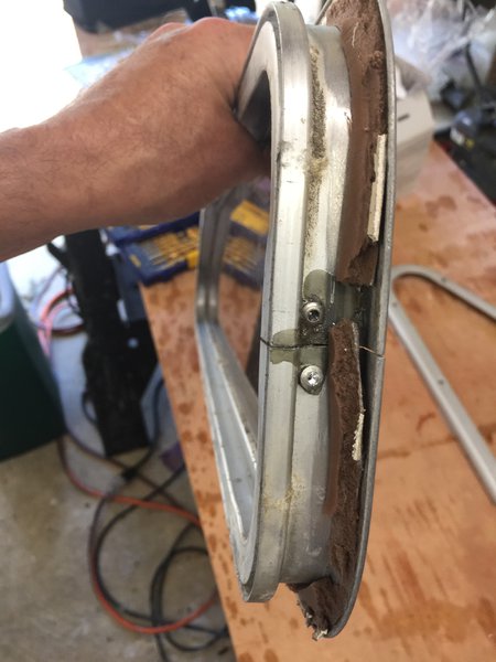

Quick question to the group... So the "wood" on the interior level where the portlights are is in pretty poor condition. Checking the thickness there by feeling through the portlights feels as if it's maybe only 1/3 of an inch thick. This can't be all wood (I'm thinking). Is this just fiberglass with a wood veneer on the inside section? Trying to gauge how big of a prject it will be to remove all the portlights, apply new veneer (if that's all it is), and then reseat the portlights. Has anybody done this?

On ours, that panel is just veneer. Ours is in good shape - it may have been replaced by a previous owner - so can’t help you much there, but…
We had to reseal the port in the head. Not a huge job, maybe medium sized. An extra pair of hands helps when reassembling.
Are your ports the rectangular, opening, Perko bronze ports? Looks like it from the photo but if not, what we encountered may not apply.
After removing the cap nuts on the inside you can start running a putty knife around the edge to loosen old sealant. Depending on what it is this may go easy or be a huge pain. Work your way around on the outside then go inside and do the same, or vice versa. The mounting ring that holds the screws is on the outside so for us it was easier to start there. On ours, a few of the screws along the top, IIRC, were just a little bit longer than the ones on the bottom. Check that on yours, if so, keep up with which one goes where or the cap nuts won’t go on fully or won’t completely tighten when you put them back. Not that I found this out from personal experience, it’s just a theory I heard somewhere.
Seal inside frame and outside ring with your choice of sealant, and reassemble. We used butyl tape and it has worked well. Took a couple of hours but ours was pretty well stuck on except for the leaky spot.

Yes. It's an Independence, so they're rectangular Perkos. Great tips. I'll probably tackle this one one in the coming weeks.

When I bought Imi Loa the interior wood along the ports had been painted white and covered with stickers. I removed the stickers and repainted the wood around the ports matte white which looks ok and required minimal work. I seem to remember a post by Martin King regarding his work replacing some interior wood surfaces with white veneer which looked beautiful and countered the rather dark appearance below. I force myself to forget all his posts immediately as his expertise and willingness to go the extra mile are, to put it mildly, humbling. In a future I'm not entirely certain will arrive I intend to sand the interior wood, brighten it, and apply a few coats of matte varnish.

Sounds like a cool project! If you end up doing it, I'd love to see pics. I think the path I'm taking is to restore is as close to stock as I can (visually), almost like restoring on old classic car. We'll see where I end up, but I love the idea of making it look like 1981 again.
