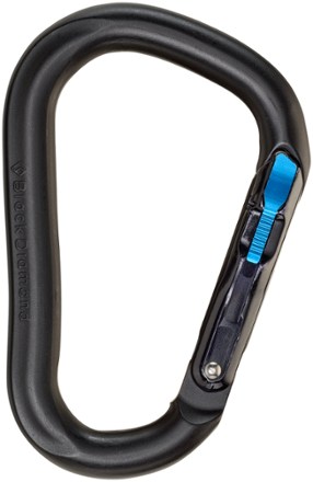

2-3 locking carabiners:
I use an auto-locking one like this for attaching the GriGri to the main loop on my harness:
I use these a pair of these magnetic auto-locking ones for attaching my around-the-mast lanyard to the sides of my harness:
Also: You'll want to get a few additional life-rated carabiners for miscellaneous tasks and back-ups (basic screw-gate and wire-gate types).
