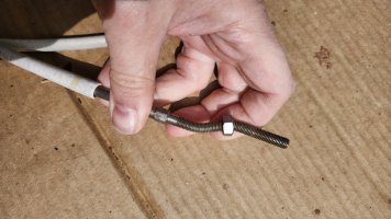

Anyway, I moved her onto the dry last year and am currently replacing her rigging. After going through all the catalogs and taking some measurements, I've discovered that her standing rigging was all 5/32" wire with 1/4" pins. Is this adequate for a 26'? If I move up, I'll have to change out the chain plates undoubtedly since they are 1/4" sized pins... sounds like a bit of work... What is the general thought on the appropriate wire size?

There's a few lines that have broken strands at the swaged fittings for the turnbuckles and one very bent fitting. Definitely time to replace but if the current wire size is adequate then I'll probably keep with that. Seems like the more things get changed, the more complicated it becomes.
