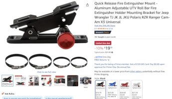

This fire extinguisher mount has worked out pretty well. This is up high in the lazarette, which is on starboard on our model and otherwise unused space. The tricky bit was getting the right shape and angle for that wooden wedge and shaping its back to mate with the irregular hull surface. The tiller handle is stored inside the larger tube and supported by sections of foam pipe insulation.
