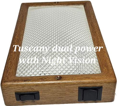

I am curious as to whether you researched the various light fixtures from https://www.alpenglowlights.com
I installed one of their hi-lo white-red fixtures over our galley many years ago, and we are still enthused about it.
This looks like the current version, and we ordered ours in teak.

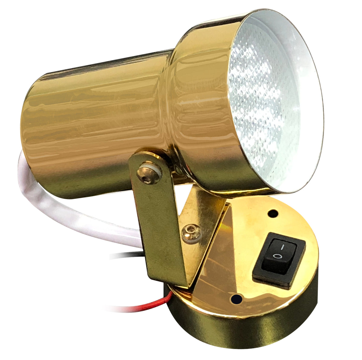

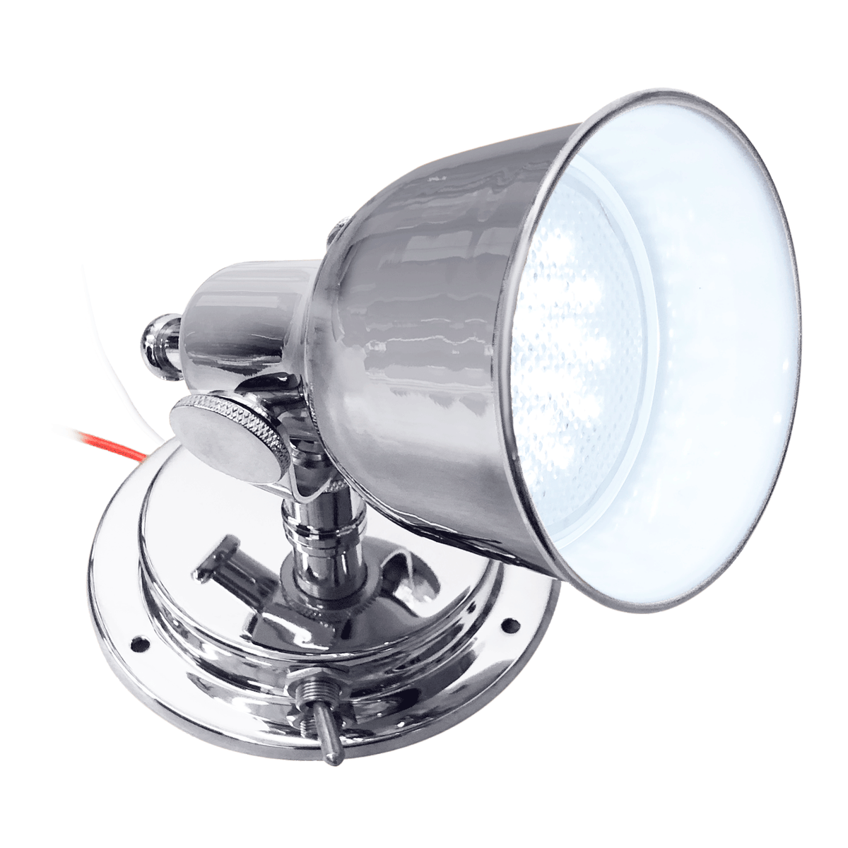

Their site no longer seems to list a brass reading light, altho they used to make them. Luckily our EY factory reading lights are still looking great, with upgraded LED lights in their sockets.
The Alpenglow light is a high quality item.
The 381 is as about as traditional as you can get, so I stuck with the original shapes.
