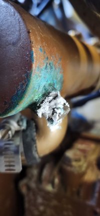

1. What's going on (chemically speaking) on the outside of this pencil zinc? (Attached pic of white material on 11mm hex-head)

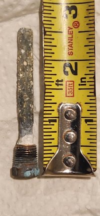

2. How can one diagnose a cooling system with corroded zinc (pic) like one can of combustion with a used outboard spark plug?

a. Save my nail polish for my toes and allow as much zinc to be exposed...just change zinc every 6, 8, etc months for your conditions...sooner if changing environments.
b. Check more frequently than.I think I ought to.
c. Save my Teflon tape for PVC cause electrons NEED metal-to-metal contact between anode and cathode.

What is the makeup of.the white stuff...forgot to taste it! Argh.
