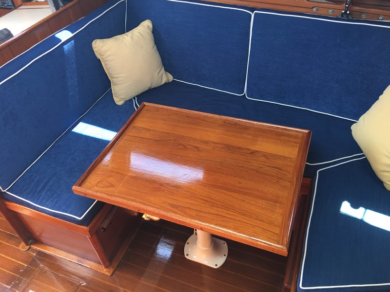

It might help to post pics of the pedestal so we can see if ours is a match. If so, I could send you some pics and take measurements.
I don’t know if this is original but it looks like it. Just big enough to be functional, folds up to allow access and is easily removable with a friction fit post when you want to convert the dinette to a sleeping area. I can get measurements next week if you like (probably about 14 x 28).
That's nice with the lee bumpers (correct term?) on one side but opening up with flat edges. Very versatile.

Thanks guys. Frank’s table looks like others I’ve seen in for sale postings and his pedestal is the same as mine. The design in bigd14’s boat is certainly interesting though the pedestal is different. Is the top not easily removable and repositioned for conversion to a bed?

With a telescoping post, a correctly sized table, when fully lowered, should fit in place level with the adjacent seating and supported by the provided cleats on the face of each section of seating. At least that's the way the 32-3 is and it is common on other boats. When lowered into place, the table should fill the space created by the three sections of seating, and the post, along with the cleats at the edges of the seating, should provide support for that portion of the "bed" thereby created.

If yours looks like mine the table top lifts off the pedestal. There are bolts at the top and bottom that can be tightened/loosened to make removal easier. Once the top is removed, remove the pedestal and place it on the floor. Place the table top on the flanges, then place a rear cushion on top to make a double bed level with the seat cushions. We had a foamy made to put on top for extra comfort.
