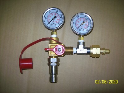

I have CNG and prefer it over porpane for the safety factor. Here in Chicago I have only found one place to exchage tanks and its $100 plus an extra $25 to test and certify your tank if its out of date.
Found this adaptor on Ebay but have read elsewhere that they may not be safe due to higher pressure at CNG filling station pumps.
more on the subject here.
