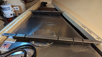

The tank Coastline Equipment made for me is 1/8" 5052-H32 aluminum and included the fuel sender, vent tube, fill tube, and draw tube. It also has a beefy cleanout port that's about 8-10" in diameter. Jayson was very communicative and easy to work with. I've had zero problems with the tank. I'll be the first to mention I haven't sailed my boat a ton since installing the tank in Dec 2023. The rig came down (on purpose) from April 2024-2025 for a massive overhaul. Rumour has been out for day sails and local cruises around the bay, but no big ocean sailing or coastal cruising yet.
PXL_20231221_040526191.MP.jpg PXL_20231220_214502514.MP.jpg PXL_20231220_221219833.MP.jpg
One note on installation: I glued 1/4" thick strips of heavy neoprene rubber from McMaster-Carr to the underside and corners of the tank with 5200. This will hopefully keep the tank from rubbing on the unfinished fiberglass in the fuel bay in the port quarterberth of the E32-3. I also zip-tied strips of the rubber under the retaining bars to hold the tank in place. Jayson and I agreed that making the tank a wee bit smaller than the old tank was wise to ensure it fit in the boat.
