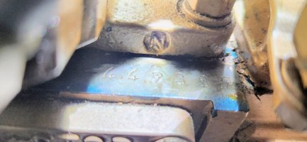

@Christian Williams 's pic of THELONIOUS II block is an example of how some engine may be stamped.

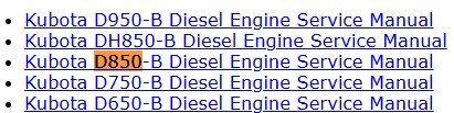

Example of listing screen shot with Kubota D850 (M25?) attached.
Parts list with part numbers and superseded part numbers (in digital format), would be cool to find.

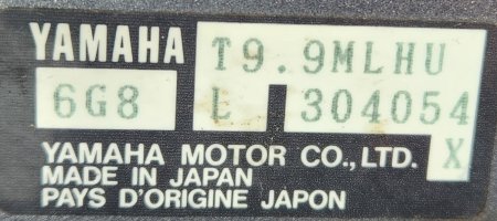

Why does this matter? Well... I work often with outboards...and I simply HATE seeking parts...when I wish to spend time learning how to use the part. For example... I get outboard, take picture of engine tag, use Google lens to copy tag, cross link it with a digital records/schematics of an online parts supplier; record hyperlink in Google contact. Then, when I need parts... I reference hyperlink to engine parts/schematic; determine part numbers, ask my local supplier down the road for availability, ...if not avail, order it if needed ASAP...or wait for local delivery. Oh Yes, each letter on outboard tag means something...see this hyperlink:, https://www.boats.net/catalog/yamaha
Example of Yamaha 9.9hp...hyperlink for parts and tag pic attached.
...but then, you all knew this already...

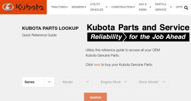

Okay... above is an example of an online KUBOTA parts look up. Just love it:)
Wait... :*(
Personally, I'm already "stuck" considering the first drop-down menu of "SERIES" I just don't know for my Universal M25, supposedly D850 (what does the "D" stand for?); Is there a "-" between D and 850? What's the SERIES, if D850 is the model?
... or does this particular online supplier just not sell D850 parts?
This online supplier needs to know the following about one's engine:
SERIES, MODEL, ENGINE MODEL, and less likely the DECK MODEL
Any Kubota professional out there to clarify?

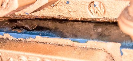

Soon, I'm going to try to find a puddy-filled series of letters&numbers on an engine block and will report...
EUREKA! Thar be one letter, numbers and a "-" stamped upon my engine block!
No puddy filling the stamped block model D850 nor the serial # _____________ Can you find it in the picture(s) attached?
Here's how the discovery went down in real time and piss-poor videography...
