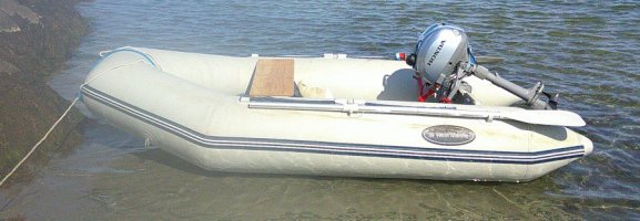

Our current dink is an old West Marine ~9', PVC unit with a four-part plywood floor and plywood transom. We bought it used and it's developing leaks. The repairman patched some but said the seams are starting to go. Also it is a Royal Pain to assemble and disassemble. The main grief is getting the four panels together with the aluminum side rails and under the tube/floor junction. A rubber mallet helps, but it takes about an hour and involves a fair amount of swearing. The inflatable floor on the TK seems like it should be much easier to install.

The bagged boat alone is just about the same as the old WM dinghy. Pictures tell the story. Using a bathroom scale I checked the weights. Interesting, 2.75m with a wood transom vs 2.5m with an aluminium transom.
WM boat: 53.0 lbs
TK boat: 52.8 lbs

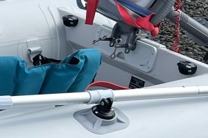

True Kit equips their boats with RailBlaza mounts for the oars and as an option for other gear mounting. We got two mounts added to the transom. We hadn't researched this aspect well. At the RB website a number of the products are labeled 'sold out'. There are a fair number of items available on Amazon, but also gaps. I ordered a couple accessories there about a week ago and one is on the way, while the other still hasn't been shipped. In our limited use, the oar mounts work fine, but seem unnecessarily complicated. RB is a New Zealand company so I expect they're trying to keep it all in the family.
Our old WM model is MS-275/0 FL which has a plywood floor with aluminum side rails to connect the four panels. Plywood transom. Homemade plywood seat. Their PSB-275 is closest to this, though with an aluminum floor.
