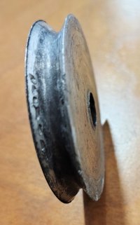

I found:
1. Worn, damaged sheaves. Note the abrasion marks on the sides from contact with the sheave box inside the mast.
2. Poor fit between axles and sheaves--allows sheaves to wobble and abrade against the mast. Replace with new from Zephywerks.
3. Scratches, wear marks, and deformations on both sides of the sheave box from contact with the sheaves. These had to be smoothed out with a sanding drum and a sanding attachment on an oscillating tool.
Much easier to fix if you lower the mast, but it can still be done with the mast in place.

I went up the mast yesterday and it turns out that the 2 issues seem unrelated. The sheave is making all the noise, which is what we suspected, but it doesn't seem to be the source of the problematic friction. We think the halyard is fouled inside the mast on one of 2 wires running to the top of the mast. Next step is we're planning to take the mast down. We'll replace the sheave and see if we can find and correct the fouling. Two skippers way smarter and more experienced than I am are leading this effort.
