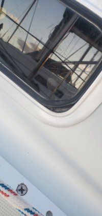

Hey folks, I'm in the midst of doing the windows on my E27. Everything is taken apart, glass is still in great shape, and I'm slowly cleaning up the frames. Other than some 4200 that a PO had attempted to squirt behind on of them, there was nothing but very old (and crusty) foam weatherstripping between the frames and the boat (I'm amazed that they didn't leak more than they did). On the plus side it's easy to remove and clean up.
I was hesitant to order the kit from Catalina Direct because I was unsure if the seals were the correct size for my specific frames (they don't offer refunds for non-Catalina owners!). But I contacted their tech support, and they kindly updated their product page with detailed rubber seal dimensions, so now we can confirm if they'll fit our windows and order with confidence! :)
