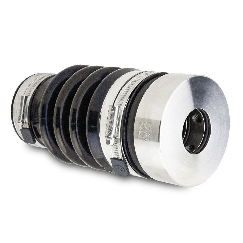

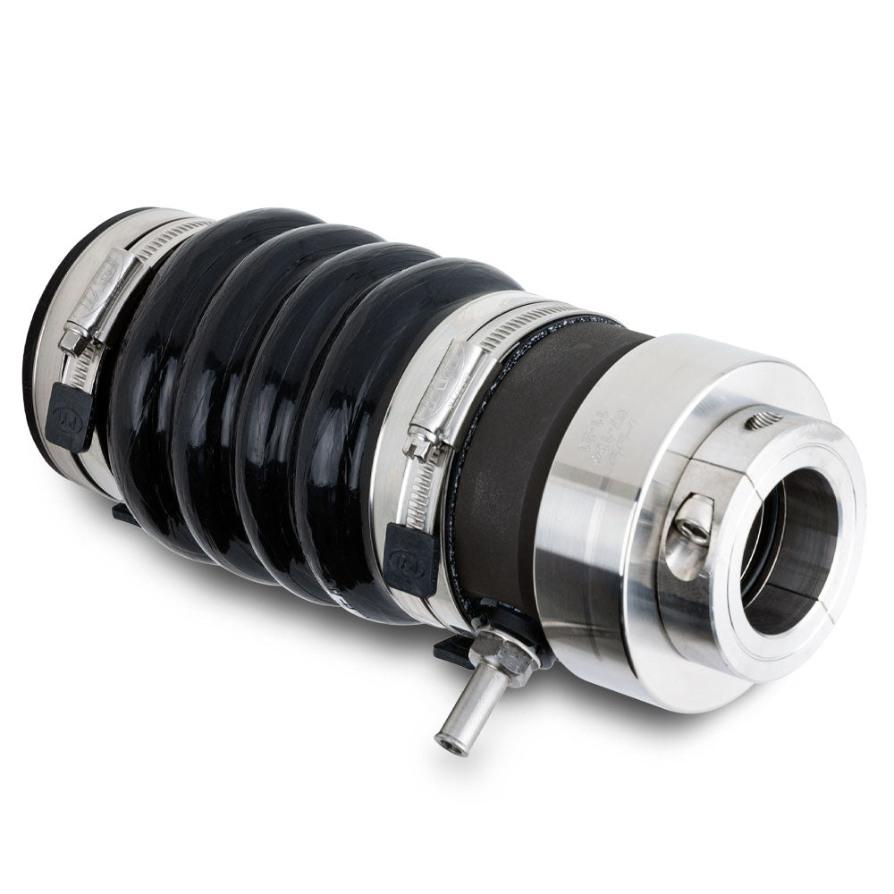

I would be very tempted to use another, non-bellows style, of shaft seal.
Typically bellows are used when a u-joint or similar is employed (as on a sterndrive), as the driveshaft requires the ability to articulate the seal, aka bellows. For a shaft seal, bellows make no sense to me over something like a proper double-clamped steel reinforced tube.
Something more like this:
Or this:
Dave G.
1984 E30+ (SOLD)
Those also have rubber/plastic tubes that go between the rotor and shaft log. I personally believe the PSS seals to be the tried & tested product. I know nothing about the DSS & Glide products above and I don't know anyone that has installed either. I'm sure they work fine too but they all seem have the same basic design. Yes I guess there is a minute chance of a rupture but I would not feel in the least bit concerned going offshore with a PSS shaft seal.
