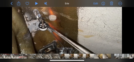

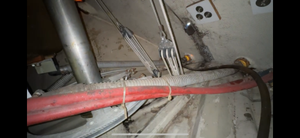

I do have a weird one though. In the lazarette there’s these two weird triple blocks that are attached to the aft stringers. Then another block that goes to through gge hull and into the rejoin in a union of sorts to make the back stay. I understand it’s some kind of racing tunable backstay arrangement… I just don’t know if I need (or want) it.
The boat came with RBS, but I don’t race, but I do SH, and I don’t need the complication. And I don’t know if this is related to that or something else.
Also… THOSE LOOK 45 years old! Is that 45 year old crappy rope the only thing keep my mast vertical???

The 33RH came with a multi-part mechanical backstay adjuster, rather than stock hydraulics. At least that's my understanding of it after having two of these models in our club. There were a lot of parts for a lot of force multiplication, and it was adjustable from either side of the cockpit, IIRC. One owner converted to to hydraulics. Seth can accurately fill in the functioning, I would guess.
Seth
Yes-the race option had an underdeck backstay purchase, which I understand never worked smoothly as there was a fair amount of friction. I am sure any good local rigger can make some adjustments to improve the function. An adjustable backstay is really important to get any goid upwind performance. Needs to be nearly loose in light air and progressively tighter as the wind comes up to both flatten the main and remove headstay sag. You really need at least 24:1, if you can get it, set up in a cascading system. The runners are needed when racing to keep the headstay further under control independently of the backstay, but they are not required for day sailing or cruising as the rig is pretty stout. You want to secure the runners as far back as possible so they are closest to centerline. If you lead them to the rail forward, they will pull the mast to windward instead of back.
