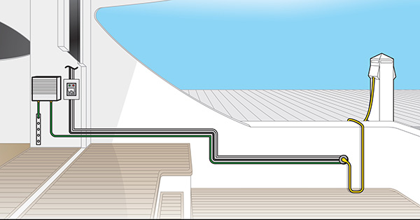

A galvanic isolator can help in preventing corrosion due to poor grounding, particularly if you are usually connected to shore power.
