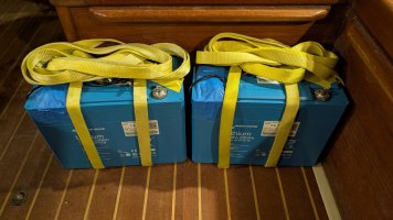

  • 2 x 200Ah Victron SmartLFP 12,8V batteries (can already hear @Christian Williams protesting my shenanigans :p)

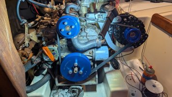

  • Arco A225s alternator and corelated J10 serpentine belt conversion
  • Arco Zeus alternator regulator

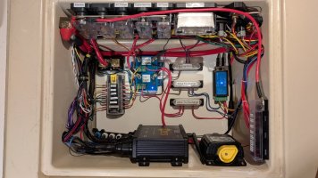

I went with Victron because I wanted a lack of surprises and the ability to tap into the logic of the battery's BMS. With Victron (and Epoch and a couple others), one can plug in an external BMS device which can intelligently signal to cut chargers or loads when the internal battery BMS says it's in trouble -- before the BMS disconnects the negative terminal. This allows direct charging of the Victron LiFePO4 batteries from the alternator. The BMS will signal to the Zeus to pull field current if there is an overvoltage, imbalance, or overtemperature condition in either battery. The old battery box has been repurposed for this charging system control, positive bus fusing, the regulator, and shunt measurements.
I have the alternator detuned to a max output of 160A. It will push ~250A cold and ~190A hot, so I might have some tuning to do in the future.

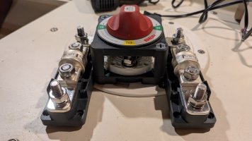

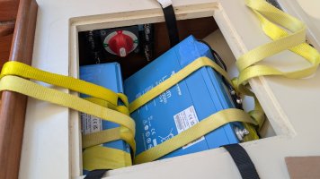

I wanted two batteries rather than one large one for redundancy. If one battery suffers a failure, I rely on the other. Real estate is an issue on the E32-3... I found a nesting location under the port side berth in the salon. I built a little shelf and installed a 1-2-BOTH-OFF switch with T-class fuses. Dead shorts on lithium batteries produce huge currents due to the miniscule internal resistance of the battery. The isolator switch can be used to de-energize DC for the entire boat from the new battery box or isolate a failed battery.

Does the alternator regulator need cooling air? Perhaps some vent holes in the battery box?

I've been wondering the same thing.. So far, leaving the engine cover on hasn't resulted in an alternator temperature above 40C. This alternator is built to run up to 110C. I have limits set at 90C. And at least for now, I'm monitoring via the mobile app when running the engine.

The E-323 engine compartment is vented to the whole back of the boat and is vented by to cowls. A few folks have even moved the hose that feeds the blower (if you have one) to the highest part of the engine compartment to extract the warmest air. Most folks don't bother. With a remote regulator located in the battery box, that's a second heat-generating unit to consider. The stock E323 battery box has no cross ventilation--just the small finger-hole panel-lift to act as a vent. If you cover that small hole with the quarterberth cushion, there is likely no ventilation at all.
Having spent several delivery days on a 32-3, I recall that indeed the battery compartment was molded in, and not served by any ventilation. I would guess that a 2" hole near the top and led via a hose to a small "muffin fan" might solve the problem. (?)

re: the non-ventilated battery box, there were no warnings in the Arco manual for the regulator about temperature control. The manual suggested mounting the regulator vertically if in a compartment with moisture, so that the harness connections don't get wet. Searching around online didn't produce any warnings about heat generation either.
I assumed those were heat sink fins on the unit in the battery box photo in post #4, above. But maybe they're not. I'd probably just call the guys at Arco and ask them.
If ventings is required, I wasn't thinking a fan, just two vent holes. One placed hi and one low to let convection take place.
