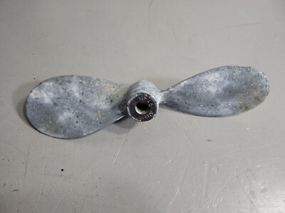

Thank you! I found a prop on eBay that I believe will work in my E35
RedDog
Seth, with my current prop I could never make that turn to starboard, backing up. Not even close!
Christian, this prop looks like it will work on my E35. What do you think?
