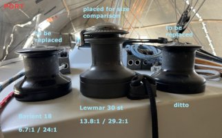

Based on the way we use the outboard starboard cabin top winch, it became an increasing priority to get the self-tailing function. Last Fall I picked up a pair of Lewmar 30ST winches for a song and am working on swapping out the old Barient 18s, same locations as in post #15, above.
I hadn't payed much attention to power ratios prior on this, thinking generically in terms of physical size. Apparently at some point winch manufacturers (some/all?) adopted the convention of model number being approximate to the highest power ratio (calculated with a 10" handle). For earlier winches an Enigma Device is required to decode the information. (thanks Loren and L-36) The Lewmars are a smidge more powerful than the old Barients.
*Extrapolating from Loren's equivalency chart, the Barlow 23 is ~ 13:1 / 33:1

Because the 18s were okay for power, I think these will be adequate. In an ideal world we'd want the 40s, but at $600 v $3200 (or even $1600 at BOGO) this was an easy compromise. We've got the most powerful winch on the mainsheet and I'm frequently glad for it. (The default setting is clutch open, but that's available for when we need the winch for the other two mainsail controls. It's not ideal, but has worked for us so far.) We can use the Barlow and spinn halyard if we need to hoist someone aloft. Line legend in post #15, above. However, if they need to go aloft to fix a deployed spinnaker, it's over to the L-30 with the auxiliary spinn halyard.
Visually, it will be a motley crew of winches up there, but, oh well.
I'll drill and pot the new holes and will be paying attention to the orientation of the drive gear and stripper ring. There's clearance for a 10" winch handle. But is there anything else I'm missing in placing these?

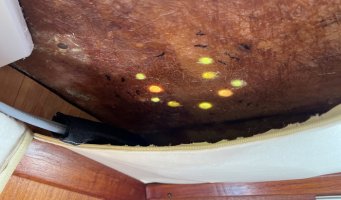

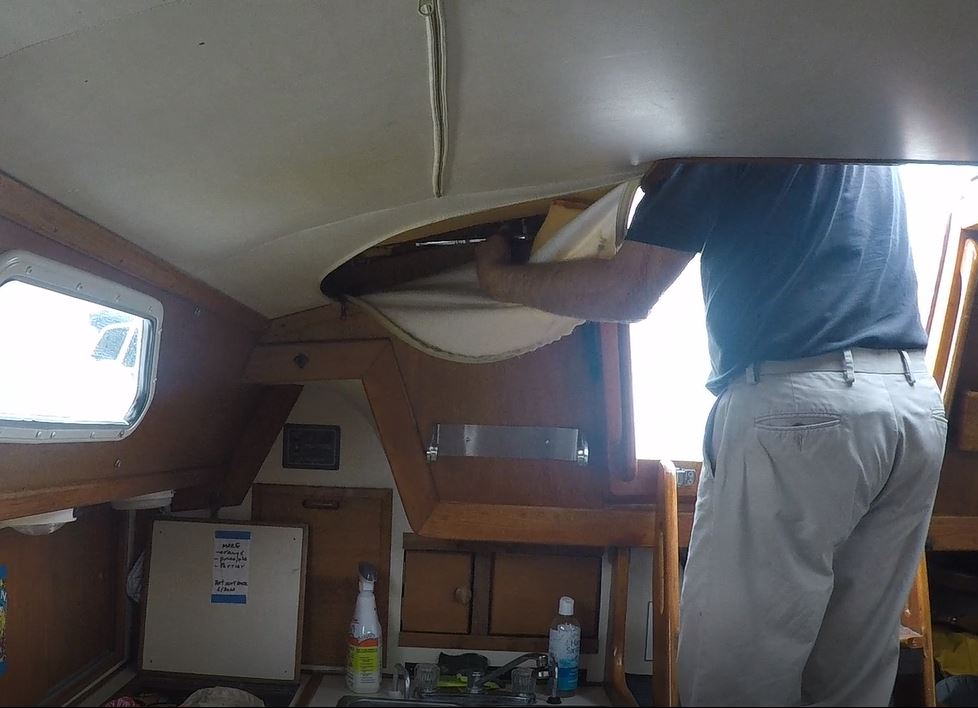

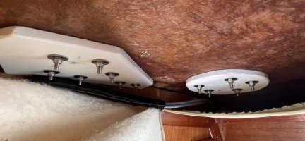

The upgrade winches are installed and it sure is nice to have the self-tailing function. The marginal bit of extra power is noticeable as well. The hole pattern is starting to look like a kaleidoscope. We still haven't got around to line bags, Christian, but they have moved well up on the list. We are launched and yesterday we moved to our summer mooring. Let the games begin.
