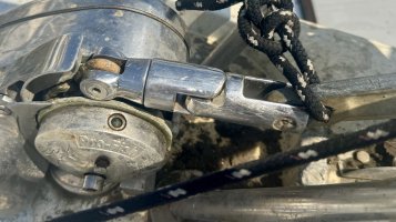

Like this? https://shop.hamiltonmarine.com/pro...ainless-steel-for-1-4--5-16--chain-29249.html
Solarken
That’s the one I use. It’s been pulled a 90° and flopped the anchor many times. Even over 180°
Got hundreds of hours at anchor ⚓️ Hell thousands.
