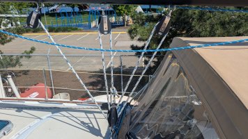

@bsangs here is a pic of my main sheet setup. I have never noticed a problem with not having enough leverage or with having too much friction in light air
