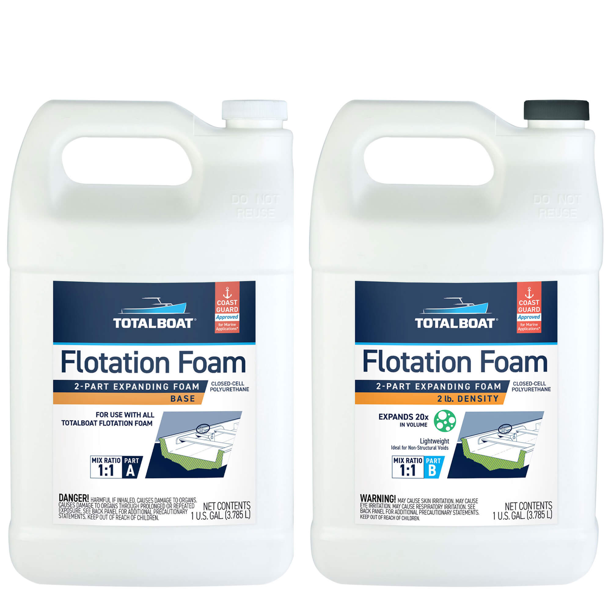

Chris be careful that the Lowes foam is a structural foam and has good solid compression numbers. Injectadeck is 400psi in compression.
If the Lowes stuff is water activated and 400PSI I want to know about it!

Chris: I thought about that as well. From many marine suppliers, you can also buy a 2 part gallon of product for around $100 ( but less than 400psi). According to the instructions, there is a 6 month life to use the premix product before it ages. You have to Pour equal measured amounts into a separate bucket, hand mix quickly but throughly, then pour before it firms up.
The problem is you have to drill large 1"-2"++ plugs to pour into the deck or you will have one heck of a mess using smaller holes...you can't use a funnel as it will clog up quickly. Maybe you can reuse the plugs? Then you need to mask those off. The "$3" Chinese gun requires no hand mixing, has a nozzle applicator that can pour a click measured amount into 1/4" or less hole. Loading the double cartridge into the gun takes less than 10 seconds. The sealed cartridges can be stored for much longer periods of time. Plus the gun comes in the kit...and you can reuse it forever, just purchase new cartridges as needed over the years. It's simply a better mouse trap.
Think about the whole picture when trying to save a few bucks and have a positive result with minimum effort. However, you may have applications that will suffice with larger drilled holes other than the deck? Yes, I thought long and hard about saving $$ vs. effort...but does it really? The choice is yours.

Chris: Seems like you do everything to perfection...very admirable! Love to see some photos!! Note that Injectadeck is 12# density...not 2/6#. May make a difference, may not? Actually, I don't know and need educating! Maybe someone can enlighten me??
Just a thought...maybe the Injectadeck cartridges can be reloaded with 2/6# ?
wynkoop
12lb is much denser and will take much more pressure to crush than 2 or 6 lb foam. I would expect 6 lb foam to have 1/2 the compressive strength of 12 lb foam, but it has been too many years since I did strength of materials in school.

As for pour foam, it is great for filling spaces to provide flotation, but most don't consider it as structural. Boston Whaler is a major exception.
But in the repair described, the space is occupied by wet gram cracker goo.....the deck on your boat is likely about an inch thick, consider the expansion of pour foam.....it needs to be contained, with relief holes.
