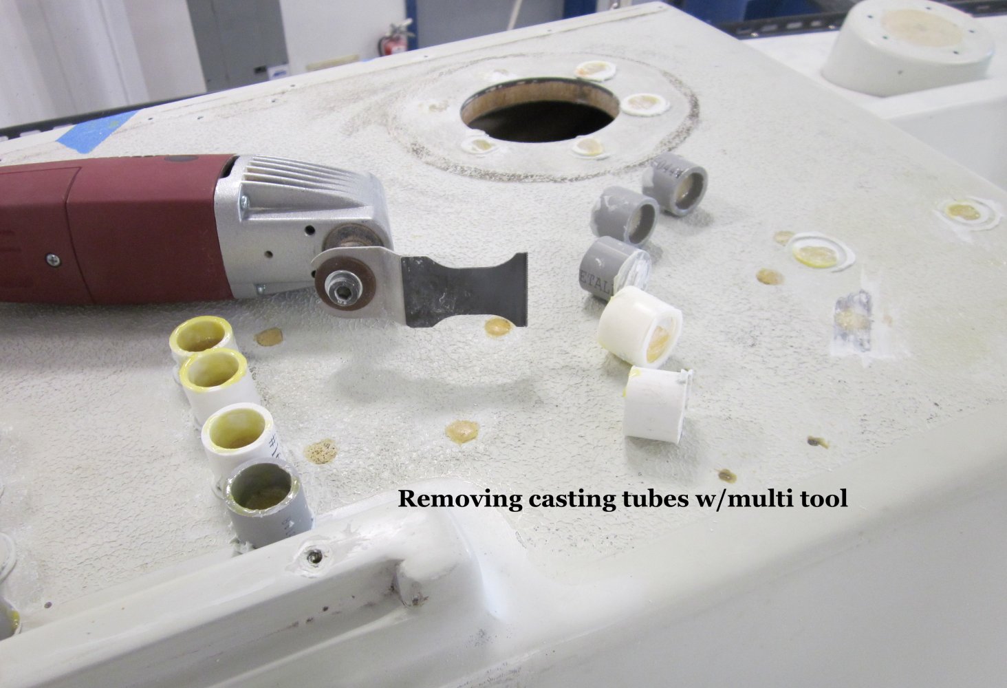

So far I have done the port side coach roof on Silver Maiden. I have also done the starboard side coach roof to within a few inches of the grab rails. Project for this spring is to remove the starboard grab rails and inject through their holes like I did on the port side. I got caught with cold weather last fall.
I have used a little over 1/2 of the large boat kit. I still need to finish the starboard coachroof then move on to the port and starboard decks next to the cabin and the foredeck. The last will be the cabin sole which is getting springy in places.
Where I have done it it is rock solid like the day it was done even though I have not yet plugged the injection holes with epoxy. I figured I would do them all at the same time, especially since I got into cold weather last fall.
I would recommend this over cutting the deck off and mucking out the balsa for replacement. Be careful not to over inject or under inject. Over injection will waste product with big muffin tops out your holes and under injection will leave voids that will require another hole to be drilled.
If you get it on your decks expect a yellow stain if you do not get it removed fast with either acetone or mineral spirits, I do not recall which. This is why having a helper is good.
For my part I could care less about stains. Silver Maiden is not pretty and needs a paint job having had her gelcoat sand blasted by hurricane Sandy some years ago. Once the deck repairs are done I do plan to paint her and will be asking advice here.
When I spoke to the injectadeck guy for my boat and the amount of area I had to cover he suggested the big boat kit and said if then I needed just 1 or two more tubes to finish he would sell me individual tubes until I was finished. I expect I will be getting more from him when I am done.

The E-27 has matching grab rails top and bottom and they are easy to pull with two people. On the port side I put packing tape over the bottom holes and injected in the top holes. I plan to do the same on the starboard side when I can. READ ALL THE DIRECTIONS and make sure you have a wire coat hanger for poking and rotorootering around the edges of the holes.
When you pull your grab rails it is a good time to refinish them. Port side I sanded and then sealed with total boat penetrating epoxy, then covered that with UV stable polyurathane about 7 months later it still looks ok, but I see where it needed more attention, so when the starboard side is done I will plan for more time doing the job and learn from the mistakes of the port side. Port side is holding up better than just poly or varnish.

Thanks for the follow-up - glad to hear yours is still going strong. From what I can ascertain, you used 2/3 of 1 tube for an ~1.25 sq ft. section. I have an approximately 6-8 sq. ft. section where the top layer of glass has cracks. I think @wynkoop repaired much larger sections.
KS Dave I had close to a 3 sq.ft. section for 2/3 of one tube...I would estimate 1 tube for 3 sq.ft. or no more than 3-4 tubes for your job. I sqeezed in too much in the drilled holes causing the "mushrooms" that bloomed out of the neighboring drilled holes were very large and wasteful, but forced out a huge amount of dark bad balsa before the white foam followed. I had glass cracks also, that is why I overpainted with anti-slip deck paint....cracks disappeared.

As for coring in decks, this all relates to establishing an "I Beam" effect to make the surface stiff. i.e. the two skins have to separated but joined. This separation can be done by solid glass (extremely heavy), plywood (less heavy), or a product that joins both sides and is intrinsically lightweight. Balsa core with vertical grain is the 'gold' standard, still. Foam has been used but still can suffer moisture intrusion and can let go OR can be severely weakened by heat from the sun beating down on the deck. Note that some fine offshore boats have been built with plywood - often in squares - as coring.
Our boats have plywood under surfaces with heavily-loaded deck gear like winches and steering components on the cockpit floor/sole. Since moisture can migrate horizontally freely thru the layers of plywood, cockpit soles are especially prone to damage if the sealant is not renewed regularly. And done with care.
And *there's* the problem with ALL coring. Very few owners ever re-bed all of the deck fittings on a 20 year basis (lesser boats) or a 30 year basis (Ericson's and other high end builds). So all of the older boats finally have weak trampoline-decks and finally get chopped up and thrown away.
The injected version of a two part foam will only alleviate the symptom in the short run, but it will be a few years before it can be judged as a possible real "cure" and if owners treat it like the guy in the video and allow the water to keep entering freely thru every ignored fastening, they will have continuing damage inside and under their decks.

Having done several balsa core repairs myself, Loren, I share your skepticism on the longevity of the injected process for two reasons: first, as you point out, the source of the incoming water must be alleviated. But second, mush displacement/replacement is only part of the solution. There's still acres of wet, rotting, balsa, PREmush in there. I just don't see how replacing today's mush solves tomorrow's mush problem.
In the more invasive cut-out-and-replace process, that all comes out, leaving dry space to be filled with replacement core abutting solid, dry balsa.

BTW I got the strips of plywood idea from an article I read on line about a deck fix done by someone else. Does anyone have any thoughts on putting plywood into the deck to replace the balsa?
I saw Bruce King at our Maine Ericson Rendezvous party a couple years ago, and I was having the same questions about a soft deck repair around the starboard stanchions. He thought about it for a bit, and told me to go out and find a nice cedar 4x4 post with tight grain. Cut 1/2 inch slices and seal each one of them with multiple coats of epoxy. Cedar is almost as light as balsa and it's way cheaper than balsa core. He told me to go in through the headliner (we have a 1977 E 39B with the crappy foam backed vinyl). Going at it from below made a lot more sense than opening up any potential leaks from doing the repair from above. Bruce told me to get a vacuum bag kit, which I found through Jamestown. I used a multi tool with a flat carbide blade to cut in from the bottom and removed all the glass layer and the mushy core until the core on the edges of the void were solid. I fit and numbered and glued up each square to the deck above with thickened West System epoxy and cut some glass matt into strands and mixed those in for added strength. I then laid in a layer of epoxy soaked glass matt with the release layer, the breather layer and the bag, and sealed all the edges and tracked down leaks. Epoxying overhead is quite a challenge! Vacuum bagging was a bit of learning experience, but I got enough of a vacuum going to pull the glass matt tight. The resulting repair is still very strong 3 years later. There were some very minor voids between some of my squares that I was going to squirt in new material, but the deck is quite solid now, so I have not bothered.
I have done two more smaller repairs the same way and can recommend this technique if you are fairly competent with glass work. The investment in the Vacuum bag kit has paid off for sure. We now have no more leaks anywhere on the boat (that I know of). Replacing the headliner in 3 cabins and 2 heads is the next big challenge.

When I recored an Ericson 27 the entire bow deck with the exception of a small 2x2 foot area was saturated. The only area that was noticeably soft was the very bow section about two feet back from the stem, which looks dark in the photo below. The balsa was basically mush in this location. You can see the only remaining solid core is along the aft end of seam along the centerline of the boat to the left in the photo. In the end I took out the entire core and top skin under the non skid areas of the bow. Water had travelled all the way back to the cabin and the core had mostly separated from the top skin. Its always worse than it seems.

What vacuum pump setup did you use? I was only able to use vacuum where I could completely seal the new core to the top laminate. If I tried to replace a section in the middle and seal to the bottom laminate all the little staple holes and other random holes allowed too much air in. I would have had to leave the pump on and I still would not have had that much vacuum pressure.
I have an older JB industries DV-142N 5cfm, used peal ply, bleeder fabric and vacuum bag material from Fiberglass supply.

So, what if I plan to do both? Can I reasonably expect to seal up the mush with the foam to keep it from spreading and address all the leaks from deck hardware? We're not talking about an $80,000 boat or even a $40,000 boat. If my boat is a total loss, it's $10K. I couldn't sell it for half that in the condition it's in and my budget for this year is about 20% of that for the projects I have in mind. Is this fix "good enough" for putzing around on a lake and keeping the damage from getting worse?
Regarding my specific location, where there's a deck block, if the foam hardens as it is supposed to, would that provide adequate support for those blocks? The support is derived from the 'sandwich' effect, right? So if the filling is strong, whether it be expanding foam, foam board, or balsa, or cedar (which is a GREAT idea!), will that provide support for those blocks?
Since properly remounting hardware is almost all labor, yours, you might try using the new foam injection for the open areas. Also, remove adjacent hardware and do the over drill-epoxy fill-redril routine. I did something like a couple hundred holes that way, and never ran out the West Systems epoxy in my gallon can. I still have a partial can of their filler, as well.
