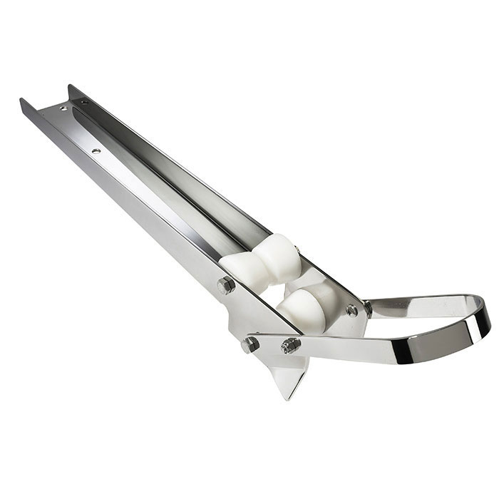

It is the model 66840009 from lewmar. 23 1/2"L x 2 5/8"w. other than the nav. light, it is a good fit and feel much stronger than the others one I tried. I had 2 extra bolt as far forward as I could and a teak block as spacer for the back part. The whole thing feel pretty stiff.

Here's the Lewmar 66840009 on the Defender website. They list the dimensions as 2-5/8" W x 23 1/2" L x 6" H. They also state that this serves Delta style anchors in the 14-35 lb range. They want $190 for it. Did you find one for a better price?

I got it from west marine. That is the only local boating store we have here. They price match it for about $150 (Defender sale price if I remember well) and offer free shipping to alaska.

Thanks for the reference to Garhauer. I decided to go with the Garhauer AR-30 instead of the Lewmar. It was just too good a deal - $113 with free shipping vs. $190.
For those who may be interested, I'll summarize the differences between the two, since Garhauer rollers are not widely available in stores and information is scanty on the internet, even on the Garhauer website.
Garhauer: one roller (instead of two like Lewmar), smaller bail, matte-finish stainless steel on interior of tray, mirror-polished ss on exterior (instead of mirror polished ss throughout on Lewmar); weighs one pound more than Lewmar. All in all, it has the look and feel of a quality product.
